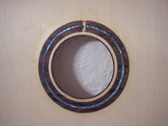

Hey All! Well here is my first big step towards a guitar... the rosette. It still needs to be sanded down a bit, but I figured I'd take a break to post some pictures. The wood is cocobolo from BobC and the abalone is from Andy DePaul (Thanks guys!!) - the purfling is 10/10/10 b/w/b.
I am pretty disapointed that a rushed the miters for the abalone, but overall I am satisfied very happy. The routing was slow but I was being extremely careful (you'll see why).

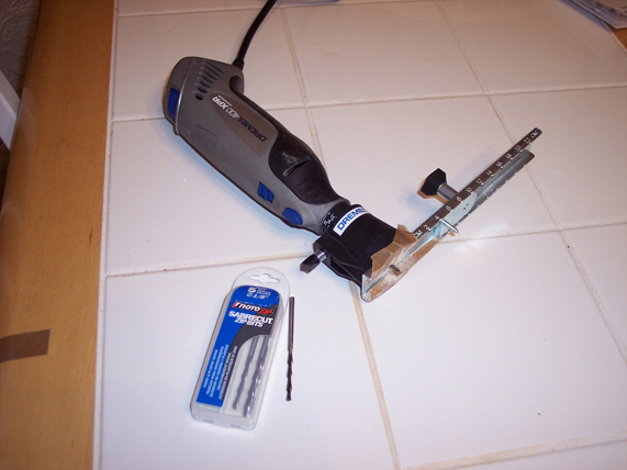

Prepare to be mortified..... yes, these are the tools that I used. Yes those are Home Depot bits - RotoZip or something. 5 bits for $5 and I didn't have any tearout though . And that is the Dremel circle-cutter which worked pretty nice actually. I obviously  plan on upgrading my tools as I go, but these worked in a pinch.

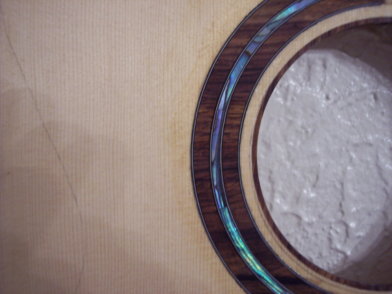

Thanks for looking everyone and the nice words, the only part I'm still a little concerned about is on the left side of the rosette. The purfling came up out of the channel a bit as I glued it and I hope I don't accidentally sand through it.
The soundhole binding was pretty easy actually. I started by taking the leftovers (center) of the cocobolo I used on the rosette and cutting out the center to get a ring (with the dremel and circle cutter). The ring has an ID of (aprox) 3.75" and is 0.080 wide. Then I routed a channel deeper and deeper on the soundboard as if I was cutting out the sound hole - but I left just a paper thin amount behind. The bit actually went through lightly in a couple spots. Then I basically just inlayed the ring in the channel. I used LMI glue and it was a very very tight fit - I put a weight on it and let it sit for 45 minutes. That was about it.

Just the fact that I rushed the whole abalone part. I could have spent more time ensuring that the miters were a perfect match... but i got excited and wanted to get it finished. Overall I am very happy, just mad because I  have to tell myself to slow down far too often.
